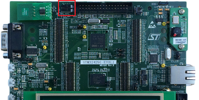

No need to to but an ST-LINK as there is an embedded one on the board and you need to connect USB cable to CN21 connector.
Sorry I meant these two switches. They need to be at position 0 as following:

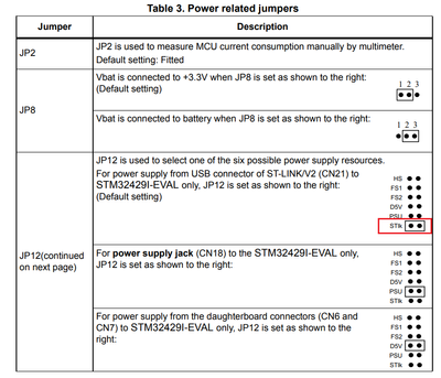

Also How you did configure the power supply? i.e. what about JP12 position?
You need to fit it at that position: "STlk":
And no need to connect the other cables as they are not needed for just to launch a debug session/program the board.

How did you connect the board to the PC?
This is the ST-LINK connector you need to connect to.
No need for DFU mode (bootloader over USB) as you are using ST-LINK.

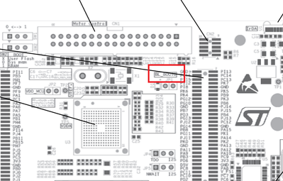

What about Boot switch position? position 0?

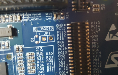

I did nothing to boot position as following picture:
And I connected all of ports(ST-Link, PSU, and USART RS-232) to my PC.

Now my board working well. I unplugged and plugged ST-Link cable before update.
Now all the board features seems okay.
