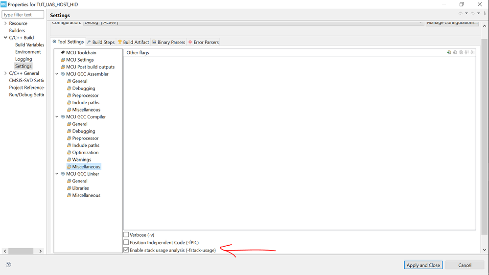

I'm looking for some info about and help with using -fstack-protector and similar compiler options with STM32CubeIde. I've never used these flags before, but enabling them does seem to compile fine. Am I correct in assuming that the GCC supplied with Cube supports this? Where is the implementation of required functions (ie. __stack_chk_guard)? Can I just override these?
Any guidance on how to use these options for STM32?

Hello @DB.7ujak​
Indeed, it is supported.
In order to use -fstack-protector in STM32CubeIDE, you can follow these steps:
  1. Open your project in CubeIDE, and go to Project > Properties.
  2. In the Properties dialog box, navigate to C/C++ Build > Settings.
  3. In the Settings page, navigate to Tool Settings > MCU C Compiler > Miscellaneous.
  4. In the Miscellaneous page, check the box next to "-fstack-protector" to enable the flag.
0693W00000aHLA0QAO.pngOnce you have enabled -fstack-protector, the required functions, including __stack_chk_guard, will be automatically generated by the compiler. You do not need to override these functions, as they are part of the compiler's implementation. It is a security feature that can prevent buffer overflow.
Hope this helps!

Hi
According to the GCC documentation, stack-usage and stack-protection is not the same thing.
https://gcc.gnu.org/onlinedocs/gcc/Instrumentation-Options.html
stack-usage is indeed useful, but it is not the feature that is requested by the OP.
Eric Stryger has made an excellent post about stack-protection here:
https://mcuoneclipse.com/2019/09/28/stack-canaries-with-gcc-checking-for-stack-overflow-at-runtime/
I have also made requests on the subject here on this forum
https://community.st.com/t5/stm32cubeide-mcus/please-change-gcc-stack-canary-to-be-weak/td-p/630140
