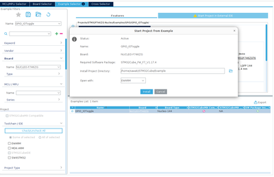

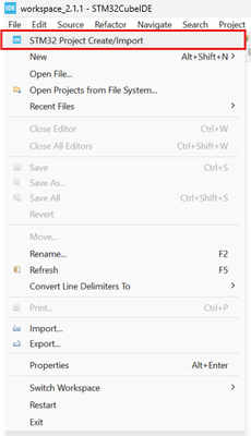

Above image you can see in toolchain option STM32IDE is disable . also i am facimng issure i =n import examples which stm32 provided for reference . you can also refer my shared video.
Hello @shreya_awati

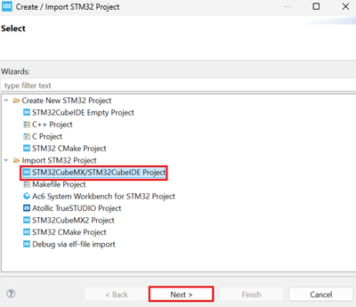

Open STM32CubeIDE 2.1.1.
Right Click on File, then click on STM32 Project Create/Import :
Thanks.

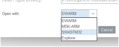

Try exporting for SW4STM32, then convert by CubeIDE project import.
Can you please provide steps from scratch .

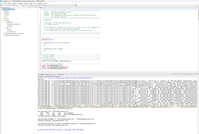

15:48:33 **** Build of configuration Debug for project STM32746ZG_Nucleo ****
make -j12 all
arm-none-eabi-gcc "/home/sawati/STM32Cube/Example/GPIO_IOToggle/Src/main.c" -mcpu=cortex-m7 -std=gnu11 -g3 -DUSE_HAL_DRIVER -DSTM32F746xx -DUSE_STM32F7XX_NUCLEO_144 -c -I../../../Inc -I../../../../../../../../Drivers/CMSIS/Device/ST/STM32F7xx/Include -I../../../../../../../../Drivers/STM32F7xx_HAL_Driver/Inc -I../../../../../../../../Drivers/BSP/STM32F7xx_Nucleo_144 -I../../../../../../../../Drivers/CMSIS/Include -Os -ffunction-sections -Wall -fstack-usage -fcyclomatic-complexity -MMD -MP -MF"Example/User/main.d" -MT"Example/User/main.o" --specs=nano.specs -mfpu=fpv5-sp-d16 -mfloat-abi=hard -mthumb -o "Example/User/main.o"
make: *** No rule to make target '/Drivers/STM32F7xx_HAL_Driver/Src/stm32f7xx_hal.c', needed by 'Drivers/STM32F7xx_HAL_Driver/stm32f7xx_hal.o'. Stop.
arm-none-eabi-gcc "/home/sawati/STM32Cube/Example/GPIO_IOToggle/Src/stm32f7xx_it.c" -mcpu=cortex-m7 -std=gnu11 -g3 -DUSE_HAL_DRIVER -DSTM32F746xx -DUSE_STM32F7XX_NUCLEO_144 -c -I../../../Inc -I../../../../../../../../Drivers/CMSIS/Device/ST/STM32F7xx/Include -I../../../../../../../../Drivers/STM32F7xx_HAL_Driver/Inc -I../../../../../../../../Drivers/BSP/STM32F7xx_Nucleo_144 -I../../../../../../../../Drivers/CMSIS/Include -Os -ffunction-sections -Wall -fstack-usage -fcyclomatic-complexity -MMD -MP -MF"Example/User/stm32f7xx_it.d" -MT"Example/User/stm32f7xx_it.o" --specs=nano.specs -mfpu=fpv5-sp-d16 -mfloat-abi=hard -mthumb -o "Example/User/stm32f7xx_it.o"
make: *** Waiting for unfinished jobs....
arm-none-eabi-gcc -mcpu=cortex-m7 -g3 -c -x assembler-with-cpp -MMD -MP -MF"Example/SW4STM32/startup_stm32f746xx.d" -MT"Example/SW4STM32/startup_stm32f746xx.o" --specs=nano.specs -mfpu=fpv5-sp-d16 -mfloat-abi=hard -mthumb -o "Example/SW4STM32/startup_stm32f746xx.o" "/home/sawati/STM32Cube/Example/GPIO_IOToggle/SW4STM32/startup_stm32f746xx.s"
arm-none-eabi-gcc "/home/sawati/STM32Cube/Example/GPIO_IOToggle/SW4STM32/syscalls.c" -mcpu=cortex-m7 -std=gnu11 -g3 -DUSE_HAL_DRIVER -DSTM32F746xx -DUSE_STM32F7XX_NUCLEO_144 -c -I../../../Inc -I../../../../../../../../Drivers/CMSIS/Device/ST/STM32F7xx/Include -I../../../../../../../../Drivers/STM32F7xx_HAL_Driver/Inc -I../../../../../../../../Drivers/BSP/STM32F7xx_Nucleo_144 -I../../../../../../../../Drivers/CMSIS/Include -Os -ffunction-sections -Wall -fstack-usage -fcyclomatic-complexity -MMD -MP -MF"Example/SW4STM32/syscalls.d" -MT"Example/SW4STM32/syscalls.o" --specs=nano.specs -mfpu=fpv5-sp-d16 -mfloat-abi=hard -mthumb -o "Example/SW4STM32/syscalls.o"
In file included from /home/sawati/STM32Cube/Example/GPIO_IOToggle/Src/main.c:21:
../../../Inc/main.h:24:10: fatal error: stm32f7xx_hal.h: No such file or directory
24 | #include "stm32f7xx_hal.h"
In file included from /home/sawati/STM32Cube/Example/GPIO_IOToggle/Src/stm32f7xx_it.c:22:
compilation terminated.
make: *** [Example/User/subdir.mk:22: Example/User/main.o] Error 1
make: *** [Example/User/subdir.mk:24: Example/User/stm32f7xx_it.o] Error 1
"make -j12 all" terminated with exit code 2. Build might be incomplete.
15:48:33 Build Failed. 6 errors, 0 warnings. (took 173ms)
These errors i got after selecting SW4STM32.

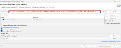

Hello @shreya_awati
Let me thank you for posting.
I recommend that you import the example from the Firmware Package STM32Cube_FW_F7_V1.17.4 under this path:
C:\Users\__\STM32Cube\Repository\STM32Cube_FW_F7_V1.17.4\Projects\STM32F746ZG-Nucleo\Examples\GPIO\GPIO_IOToggle\SW4STM32\STM32746ZG_Nucleo
Thanks.
Mahmoud

Hello @shreya_awati
Thanks.
Mahmoud
Its working fine.
Thanks

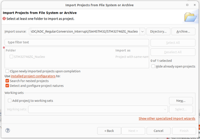

For only GPIO example is working
other not able to import
/home/sawati/STM32Cube/Repository/STM32Cube_FW_F7_V1.17.4/Projects/STM32F746ZG-Nucleo/Examples/ADC/ADC_RegularConversion_Interrupt/SW4STM32/STM32746ZG_Nucleo
I import GPIO toggle example , after that i am trying to import another example but it is not showing build option . directly it is showing run option . Then i deleted gpio example and tried to import another example then is is showing build option .
how can i resolve this issue ??
