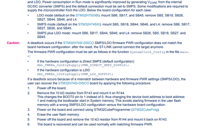

Make sure to recover the board 10 kΩ resistor from R143 and soldered on to R144 as mentioned in the Caution part, in the STM32H750 User manual.
Check also the SMPS/LDO and VOS settings.

I checked the manual. "recover the board 10 kΩ resistor from R143 and soldered on to R144" should change the BOOT0 pin to 1 instead of 0, and start in System memory for programming to fix the deadlock issue. But my issue should not be deadlock issue. If I use ST-Link (ST-Link GDB server) instead of ST-Link(OpenOCD), I have no any issue.
