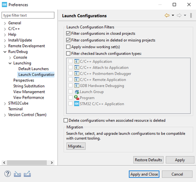

After your advices I have this picture :
So probably I must click on Restore Defaults ?

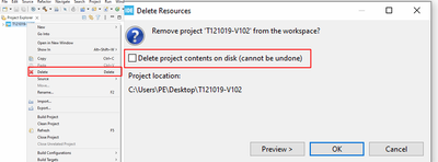

I think that you project is not correct in the workspace.
Delete ist from the workspace
and reimport it. (open projects from File System)

If I do that; I'll lose my project right ? So how to import if you have nothing on your disk ? I don't understand your method
No the picture will read as "not check this ooption"
if you know where your project with all the source files are. make a Backup
(right click on the project folder -> send it to -> Zipfolder.

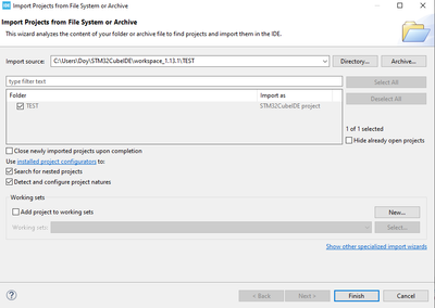

Unzip the zip file on your desktop into a folder say "Test". Delete the .launch file in the folder.
Then go to "Open Projects from File System" in the IDE. Navigate to your "Test" directory on the desktop. Then OK.
Do a "Project-> Clean" and a "Project->Build All".

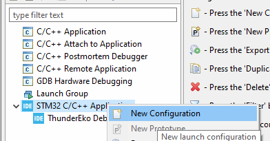

Then in "Run-> Debug Configurations". Then create a new configuration.
Apply.
Then "Run Debug".

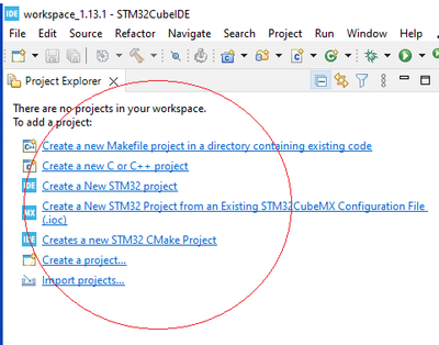

Thank you for your helps. After rename the folder and delete the .launch file, I open the the Test projet like this picture. After clicking finish
I have nothing in my IDE :

Hi
please copy the files not into the Workspace. Copy them into a Folder on your Desktop.
And then import the Folder from your Desktop.
