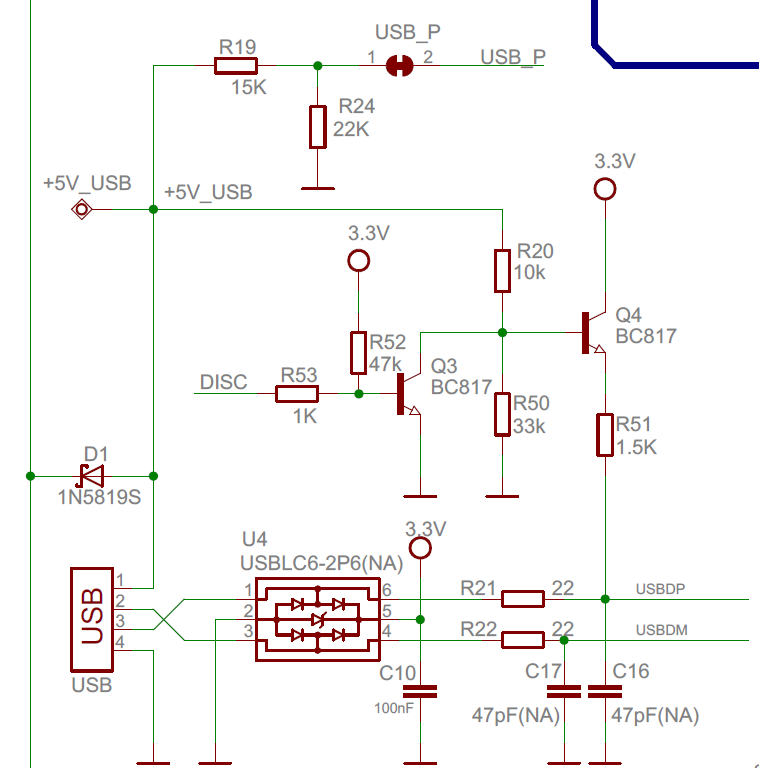

nice tutorial, it solved my issue with the STM32F103 on my Olimex-Board, not it connects. The issue was very simple:
Pin 53, DISC, controls the 1.5k Pullup. Once I configured it correctly and the pullup was active Windows detected the device and the STM32-P103 (Rev.B) Board showed up as a VCP. With a terminal I was able to receive Strings.
HAL_GPIO_WritePin(GPIOC, DISC_Pin, GPIO_PIN_SET); // Make sute the DP+ is pulled up
