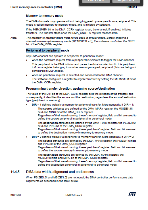

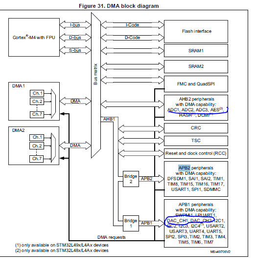

Javier1
Principal
0693W00000UoVlwQAF.pnghttps://community.st.com/s/question/0D50X0000AnrIsfSQE/stm32f0-peripheral-to-peripheral-dma-transfer
Specifics:
  • ADC in continous mode.
  • Tim2 triggering a DMA (peripheral-to-peripheral transfer) from the ADC result register to the DAC output register.
This way you could get very fast data transfers and your Core is almost free to do whatever you want.
I just checked RM0351 and your MCU should support peripheral to peripheral DMA transfers
