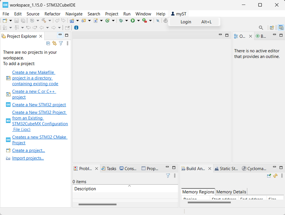

I have an issue when I tried enter myST on STM32CubeIDE 1.15.0 version. Program shows second image and close itself how can I solve this issue?

I have the exact same Problem, but Cubeide closes so fast, that i cant open the preferences to change the Firmware upgrader.

‎2025-01-31 8:29 AM
I also had this error for a whole week before I managed to fix it.
The error message goes by so quickly you can't actually see what it says... But when opening CubeIDE, the popup you get is trying to update CubeMX, not CubeIDE.
I only had to open CubeMX, let it update itself and now CubeIDE doesn't crash anymore.
TLDR: Open STM32CubeMX to let it update itself, then CubeIDE will be fixed.
