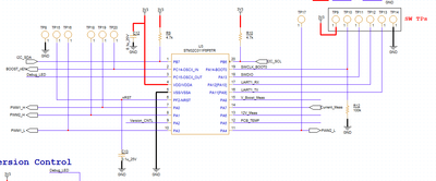

I’m working with an STM32C011F6P6TR device, and after programming it via SWD using STM32CubeProgrammer, the MCU became completely stuck in reset
Symptoms
- After programming an ELF file through STCubeProgrammer, the MCU no longer runs.
- The NRST pin stays LOW permanently, even after power cycling.
- I cannot reconnect with STM32CubeProgrammer, even using “Connect Under Reset” mode.
- The tool returns: DEV_HELD_UNDER_RESET.
- Removing power, disconnecting ST-LINK, reconnecting, and trying again does not help.
Before programming, everything worked normally and I was able to connect and flash multiple times (Using VS-CODE and ST extension).
Questions:
  1. What could cause the MCU to remain stuck in reset after flashing?
  2. Is it possible that option bytes got corrupted or misconfigured during programming?
  3. Is there any way to force a full chip erase or restore factory option bytes when the device cannot be accessed through SWD?
  4. Has anyone encountered a similar issue with the STM32C0 series where NRST is permanently held low?
Any guidance on how to recover the MCU or identify the root cause would be appreciated.
Thanks!

NRST low could indicate power issue or other serious design issue. Is VDD stable 3.3V? NRST low and not toggling? Use a scope rather than multimeter. Can try booting to bootloader to recover. See AN2606.
Chris21

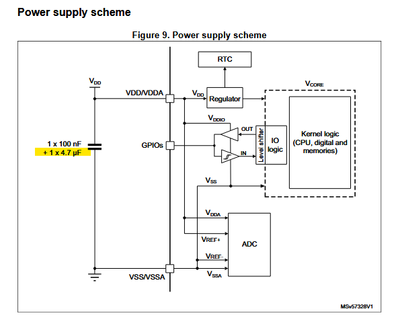

Senior III
Do you have a 4.7 uF capacitor?
