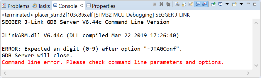

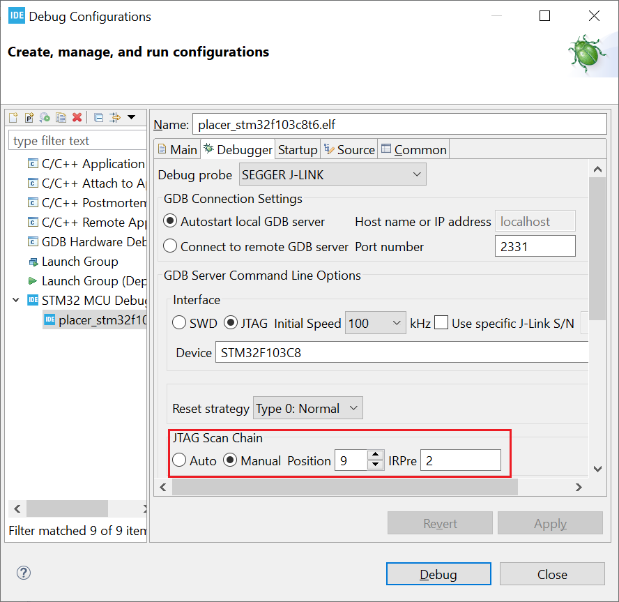

Hi.
I get this
What should I do?
Thanks
STM32CubeIDE
Version: 1.0.0
Build: 2872_20190423-2022 (UTC)
10 REPLIES 10

Looking into this at the moment, will let you know once I know more.
I could use some additional information.
Could you try to start the Segger J-Link GDB Server manually with the option bytes required? And then post the results?
Yes, what should I do?​
Ba5tian
Same problem here but different version.
CubeIde 1.2.0
JLinkARM.dll V6.62a
MKell.1
Problem still present in CubeIDE 1.3.1
Has anybody found a workarround?
DVicc.1
Hello, I have the same problem, even in the CUbeide release 1.4.2.
Regards
