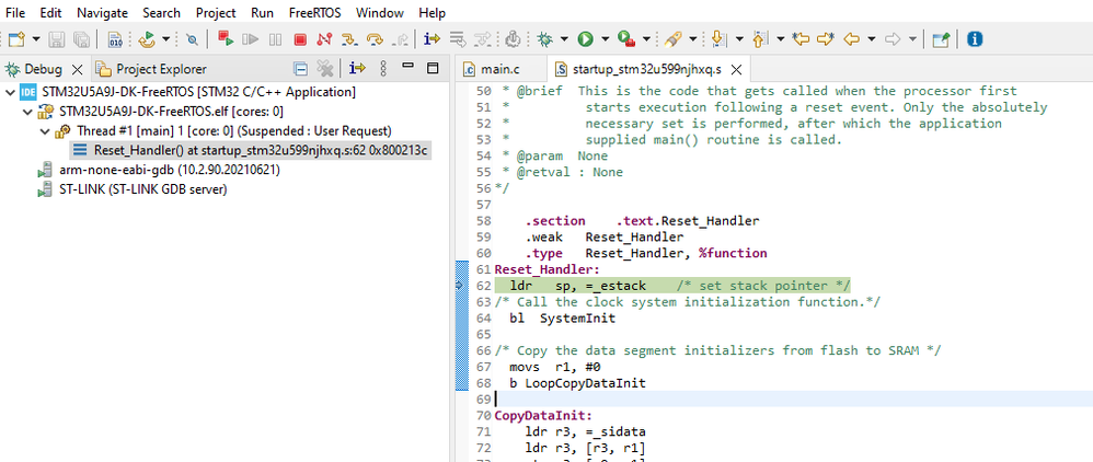

I'm unable to start my project within the STM32CubeIDE on a STM32U5A9J-DK with the debugger. I would like to use the Segger J-Link as we will use it in our custom design. But i also have problems using the ST-Link V3.
The project was generated with TouchGFX Designer.

ST-Link V3 Setup:
  • Use default Jumper settings of Dev Kit
  • Connect Board on CN5 (ST-Link) to PC
  • First time start debugging in STM32CubeIDE it works out of the Box.
  • On second time, the debugger is stuck in the Reset_Handler:
  • obviously always restart the IDE before debugging is not a valid option.

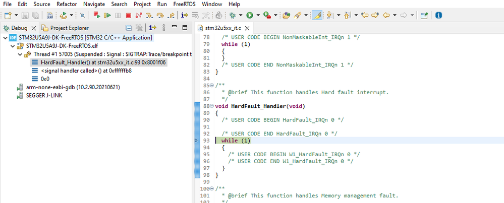

Segger J-Link Setup:
  • Move Jumper JP5 to JP6 to keep ST-Link in reset
  • Move Jumper JP4 to USBC to power device over USB-C
  • Connect Segger J-Link on MIPI-10 connector (CN11)
  • Connect Power to USB-C Port (CN4)
  • Change Run configuration to use the J-Link
  • Press Debug button in CubeIDE
    • Flash is programmed
    • Application hangs in HardFault_Handler
  • Press Run button in the CubeIDE
    • Application hangs
    • After pressing the reset button the application boots correctly.
In both cases, sometimes i was able to bring the debugger up, when pressing the Reset button on the Dev Kit. I would suggest, that the Reset of the MCU is not correctly handled.
On the J-Link i always have to press the Reset Button so it might be a configuration issue or Bug of Reset/Startup behavior.

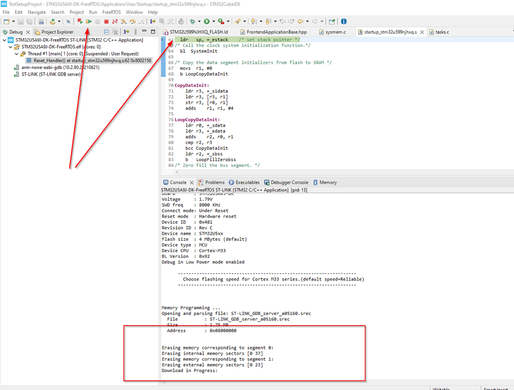

I just found out, that the CubeIDE starts the Debug perspective where it look's like it is in break state somewhere in the startup file. But in the Console, i see that the ST-LINK is still programming the memory:
So i guess, this is a bug of the CubeIDE which should wait for Flash programming before starting the Debugging perspective.
Still sometimes i have to reset the board manually by pressing the reset button first.
This is just a thought and your experience may vary.
In the debug configuration, I chose to NOT launch the debugger in the background.
Doing so seemed to resolve this annoying GUI state that would indicate that the memory download is completed but is in fact still ongoing.
