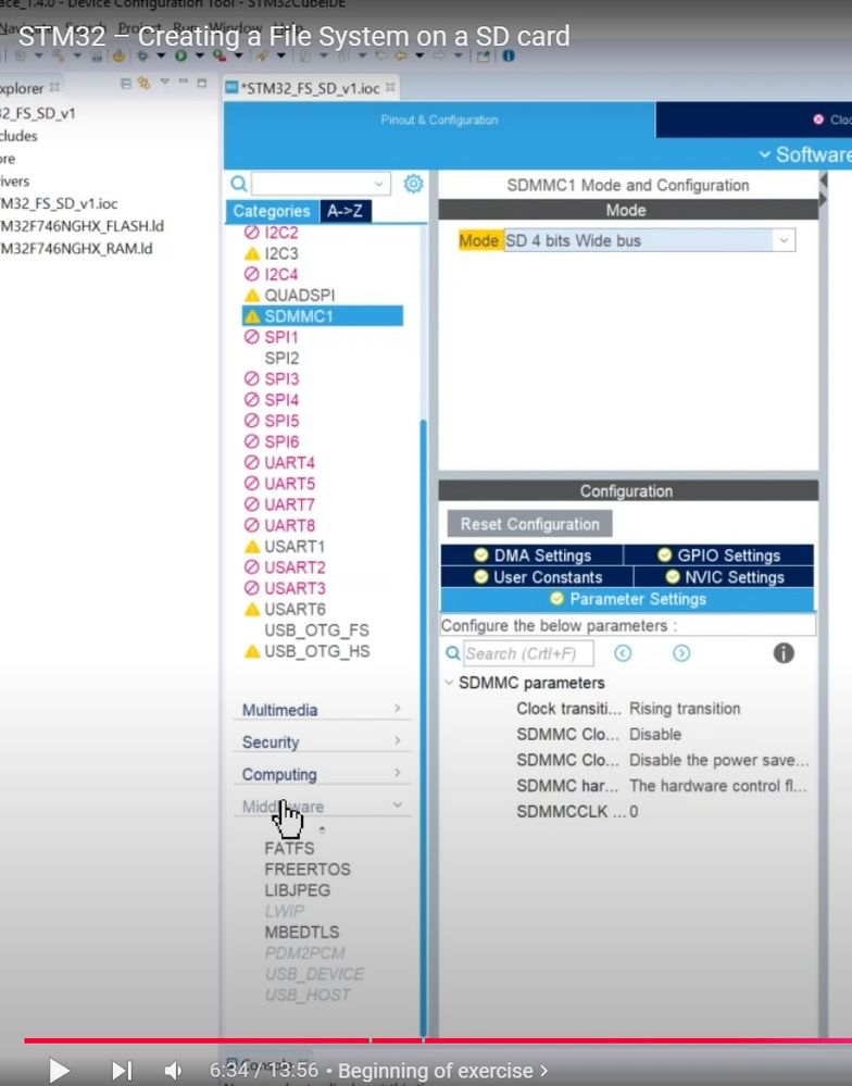

In this movie setup done  SDMMC 4BIT mode selected in CubeMX:
 Setup looks:

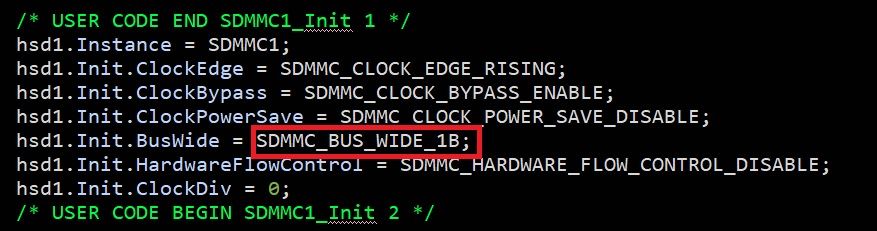

In the older versions CubeMX like video before generated code for SDMMC or SDIO 4BIT setup looks like:
 That was confusing and doesn't really running SDIO/SDMMC in 4 bit wide mode.

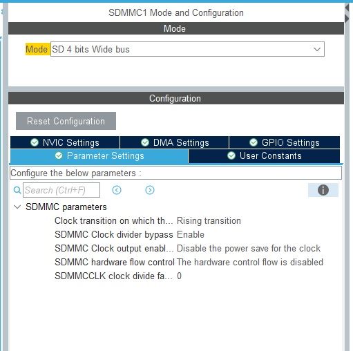

For setup DISCOVERY F746G:

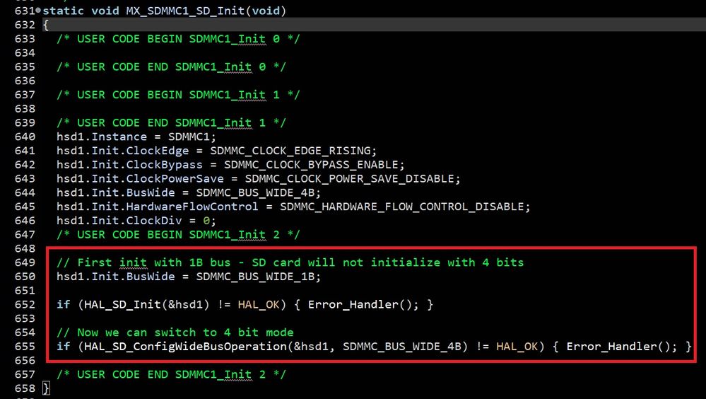

In the generated code need to add a magic few lines which was selected in the red border:
In the comparision 4bit to 1bit mode was 128ms/510KB read time for 1 bit mode versus 68ms for 4 bit mode.

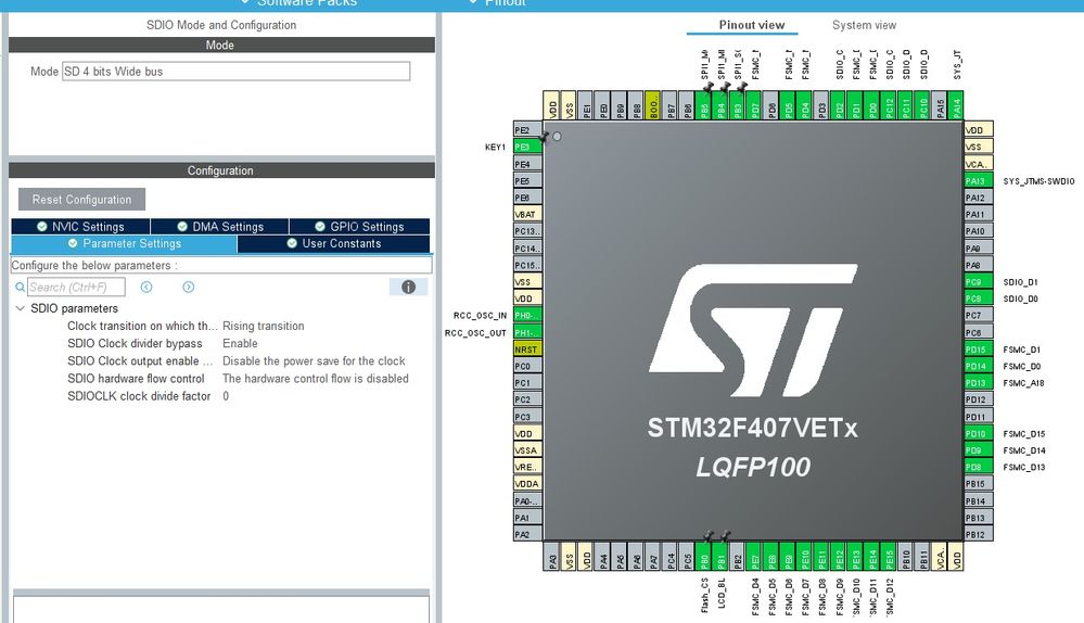

For any custom board with STM32F407VET6 was setup:

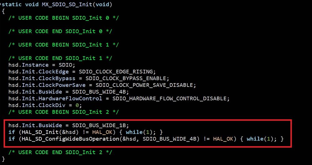

The code was very simmilary to previous:

Hello @wegi01 and thank you for the sharing.
MX_SDIO_SD_Init() should be generated with hsd.Init.BusWide = SDIO_BUS_WIDE_1B in both cases we choose SDIO Mode option
"SD 4 bits Wide bus" or "SD 1 bit".
Therefore, SDIO_BUS_WIDE_4B needs to be set at the right step : HAL_SD_ConfigWideBusOperation().
In case "SD 4 bits Wide bus" is chosen, the generated MX_SDIO_SD_Init() should follow below steps :
Step 1 - hsd.Init.BusWide set to SDIO_BUS_WIDE_1B just for initialization.
Step 2 - Call HAL_SD_Init(&hsd)
Step 3 - Call HAL_SD_ConfigWideBusOperation(&hsd, SDIO_BUS_WIDE_4B)
