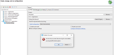

I've STM32CubeIDE v1.14.1 on a Windows10 PC. I've NUCLEO-G0B1RE board and I've created my workspace with a standard project starting from the NUCELO ioc configuration. I can build the project and upload the .elf file on the uC with STM32CubeProgrammer software, no problem, it works.
When I try to Run or Debug the project from the STM32CubeIDE, nothing happens; also if I try to add some lauch configuration from Properties->Run/Debug Settings menu, nothing happens......

Ok, opening the debug window, I obtain a strange error:

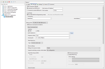

And I cannot see my ST-LINK connected after clicking to scan button:

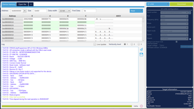

This is very strange because I can correctly program the device with STM32CubeProgrammer..... This could be the problem?

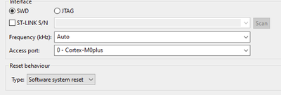

- deselect stlink S/N !
- set reset -> software (i use most time ; "under reset" only needed, if cpu in special conditions)
If I uncheck it, the box is empty:
And I have:

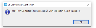

Hmmm... no st-link is --- bad.   IDE see no st-link , unplug , plug to other port , use no HUB (!) , try other good usb cable. It MUST work here…
This is very strange because I can program through STM32CubeProgrammer software....
Try : in IDE  (menu) Help -> ST-Link upgrade  --- does it find the st-link here ?
No, it doesn't. I've tried with a fresh install of STM32CubeIDE but with no luck...
