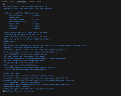

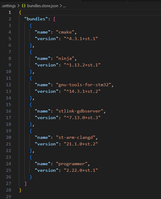

I wrote a project maybe 2 weeks ago, at that time, everything was ok.  then i used stlink to download and debug the code yesterday, at first time, it worked ok, but later, i did download and debug again with stlink. it cannot work. the log as below.
my setting as below:
so what is the problem? how to fix it?

Andrew Neil
Clearly, something must have changed!
This is probably the key:
See: Failed to bind to port 61234
(note that it's better to share this as text rather than a screenshot)

@LaurentL wrote:
Maybe a previous debug did not finish well.
If it is the case, kill the process and it should be fine.
That is, indeed, the solution proposed in the thread I linked earlier.
Hello LaurentL,
Maybe you are right, I killed the process of st-link_gdbserver running with task manager, and tried again, this time, it worked.
Thanks a lot.
