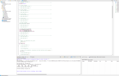

I've STM32CubeIDE v1.14.1 on a Windows10 PC. I've NUCLEO-G0B1RE board and I've created my workspace with a standard project starting from the NUCELO ioc configuration. I can build the project and upload the .elf file on the uC with STM32CubeProgrammer software, no problem, it works.
When I try to Run or Debug the project from the STM32CubeIDE, nothing happens; also if I try to add some lauch configuration from Properties->Run/Debug Settings menu, nothing happens......
Another strange thing is that in the Build Analyzer tab I have no info about memory usage....
Is there a way to solve?

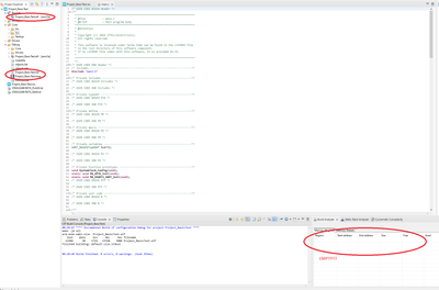

    I've just compiled the default NUCLEO-G0B1 project example, and I think there's already a .lst and a .map file:
    And here's my settings (they could be all default values):
    Is there something missing?

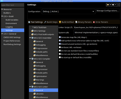

    + there is NO linker option selected to suppress the map file!  and maybe the .list file as well.

    I'm sorry, I don't understand your note, why you suggest to suppress the file? Maybe you mean generate?

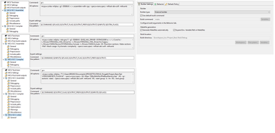

    By the way, my options are
    and I think the .map file is already generated with the linker options. Do you think there's something wrong?

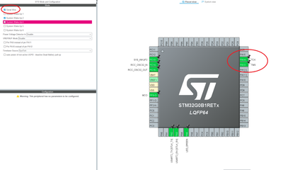

    Try:  make : menu -> file -> new -> stm32 project .... select cpu, give name (wait...until it shows ioc edit) ;
    set in ioc : debug to swd ; then generate code ;
