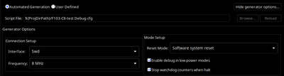

AScha.3
December 19, 2023
You could try switching to other debug : in configurations.. -> openOCD
+ set in generator options : software reset , or try "under reset" :
Moritz1
Moritz1Author
December 19, 2023
Thanks for your answer.
With openOCD everything works fine.

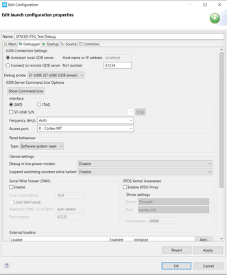

Rim LANDOLSI
December 25, 2023
I mean the Debug configuration as shown in the screenshot:
Moritz1
Moritz1Author
December 29, 2023
This is my setting (it should be default, I havent changed anything here):
Moritz1
Moritz1Author
January 31, 2024
Any idea?
