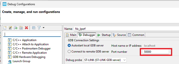

Suddently, after 6 months using the STM32CubeIde software, I got the same error:

I didn't know what could be happening. I thought that It could be something related to the GDBServer. I wanted to reinstall GDBserver or STLINK but as I didn't know how to only reinstall that components I uninstalled and reinstalled all the applications to the latest versions ( STM32CubeIde and STM32CubeMx ) but the problem persisted. After reinstalling I got the same error.
So with all the software updated to the latest version I checked with another STM32 board I have and the problem persisted  I also checked other USB cable and the same.... So it seemed something related to the ports accesss or process executions permissions.
Finally I solved the problem changing the Debugger settings in "Run > Debug Configurations" of the project. In the "Debugger" tab, I  changed port number from 61234 to 50000. Then I tried to debug again, the Windows Firewall asked me to provide access permissions to ST-LINK to the network and I accepted. Then everything started to work correctly. So despite I initially checked on Windows Firewall, it seems that it was all an problem of port access persmissions.
