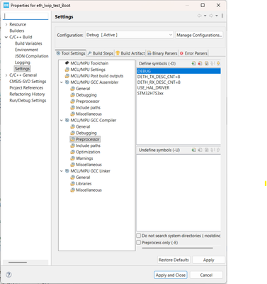

imranhassan84
Thanks for the reply.
I did in compiler preprocessor (as shown in figure attached) and to check the value I am printing on UART in ethernet.c (in low_level_init() function )but it is unchanged.

STackPointer64
Hello @imranhassan84,
The number of TX/RX descriptors is defined in stm32h7rsxx_hal_eth.h; that’s where they are referenced when descriptors are defined in ethernetif.c. I suggest you remove all the definitions you added and leave only the one in stm32h7rsxx_hal_eth.h. Then, do a clean build and search for DMARxDscrTab in the build analyzer under Memory details. The size of the descriptor should be 24 bytes multiplied by the number of descriptors (e.g., 96 bytes for 4 descriptors).
#ifndef ETH_TX_DESC_CNT
#define ETH_TX_DESC_CNT         8U
#endif /* ETH_TX_DESC_CNT */
#ifndef ETH_RX_DESC_CNT
#define ETH_RX_DESC_CNT         8U
#endif /* ETH_RX_DESC_CNT */
To improve visibility of answered topics, please click 'Accept as Solution' on the reply that resolved your issue or answered your question.
Remove the D. ETH_RX_DESC_CNT, not DETH_RX_DESC_CNT.
