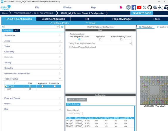

I would like to use SWV for debugging on the Nucleo-N657X0-Q board.

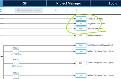

I first enabled SWV debugging and also change the CPU clock to 400 MHz.

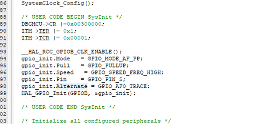

Then, I added some code to main.c (as reference here ).

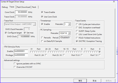

At the same time, I also set the core clock to 50 MHz in the TRACE configuration of Keil.
But i can't see any string in Debug Viewer.

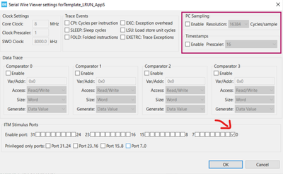

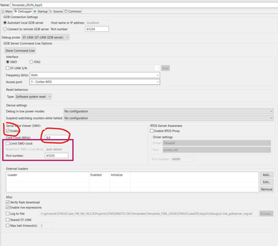

At first, I used CubeIDE, but I couldn’t see any messages in the Trace View window.
So I switched to Keil MDK to verify the output.
Now I can see the messages.
The reason I couldn’t see the printf messages in CubeIDE was that I hadn’t enabled Start Trace.
