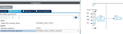

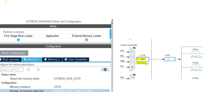

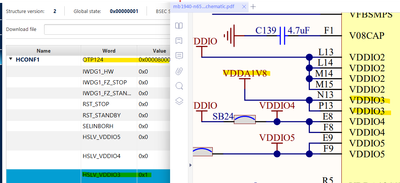

I'm learning about the STM32N6 LR and XIP examples and want to get hands-on with them. I've already set OTP124 to 0x8000.
If SYSB is configured to 400MHz, the number of memory data lines must be set to 1 line and disable "X_ICACHE_Init()" for the app to function.
However, if SYSB is set to 80MHz, the number of memory data lines can be configured to 8 lines  and disable "X_ICACHE_Init()", and the app still works.
I'm very confused by this result and wonder if anyone has encountered the same problem or knows what I should modify?
