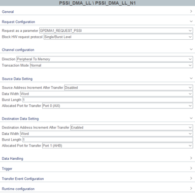

I'd like to report one issue with DMA Linked List editor. I need to do PSSI reception with GPDMA using linked list on STM32H7R3L8H6H. CubeMX is version v6.15.0 and CubeIDE is v1.19.0.
Based on reference manual (RM) and AN5593, the GPDMA ports 0 and 1 are both AHB ports, with port 0 being capable of direct access to APB peripherals. However, Linked list editor in CubeMX displays port options with wrong names:
I guess it follows HPDMA port naming. Maybe it should avoid naming at all or decide it based on the DMA channel option in the List editor.
It looks like a minor issue, but I happened to make opposite choice because memory is on AXI bus so for me it is yet another problem on the way of getting the whole thing working.

Hello @mkrk
Your detailed explanation is much appreciated.
Issue has been raised to dev team for resolution.
Internal ticket number is 218536

There seems to be one more issue with Linked list editor. Now I picked source port 0 and destination port 1, saved IOC file and closed it. When re-opening IOC file and looking at Linked list editor, destination port is 0. I look at IOC file and see that there is no separate source and destination port parameter, but a single TransferAllocatedPortSrc which is zero. Here is a block of LinkedList parameters from IOC:

Generated code (linked_list.c) also puts both to zero:
pNodeConfig.Init.TransferAllocatedPort = DMA_SRC_ALLOCATED_PORT0|DMA_DEST_ALLOCATED_PORT0;

Thank you very much for your valuable contributions.
A separate ticket has been submitted to the development team to address and correct this behavior
Internal ticket number is 218572 .
