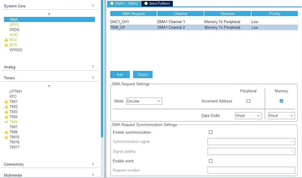

1.) Add DMA to TIM6 (which is also controlling a DAC simultaneously):0690X00000DXsclQAD.jpg

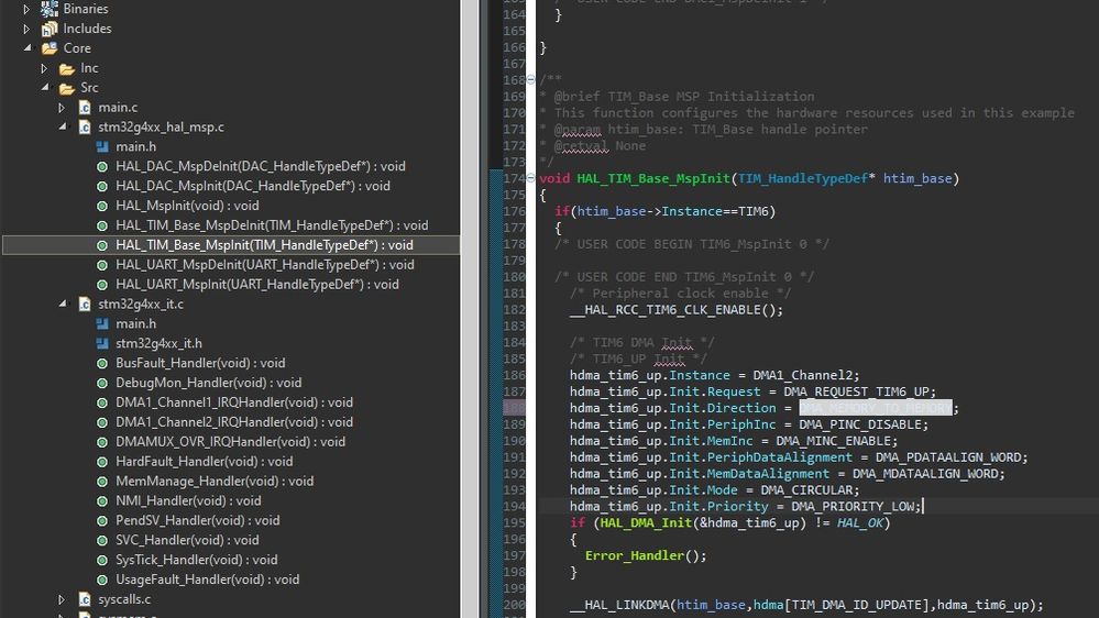

2.) Change the setting for the timer DMA in the auto-generated code to use DMA_MEMORY_TO_MEMORY rather than DMA_MEMORY_TO_PERIPHERAL:
3.) Start the transfer writing to GPIOA->BSRR:0690X00000DXss0QAD.jpg
And this frankenstein solution, which obvious gets nuked when you regenerate using a new .ioc due to modifying a generated function, ALMOST works.
I get one of the GPIOA pins changing, but at approx 3 times the rate I would expect.
