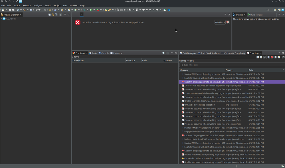

No editor descriptor for id org.eclipse.ui.internal.emptyEditorTab
sovik32
1 REPLY 1

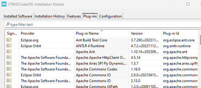

Make sure to have the required plugin :
  • Go to Help > About STM32CubeIDE > Installation Details and ensure the correct plugins are installed.
  • If the plugin is missing, reinstall it via Help > Eclipse Marketplace or Help > Install New Software.
Otherwise, reinstall STM32CubeIDE to restore the default plugins.
