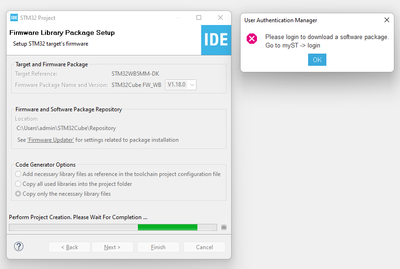

    I've just installed STM32CubeIDE 1.14.0 and I faced the same problem. I was creating my first project for an STM32WB5MM-DK board. I wasn't log in to myST when I run the New project wizard. While the IDE was generating the code for the first time, I got the screen image shown below. Pressing the X on the "User authentication manager window" always-on-top-most Window does nothing. I am not able to close any window:

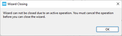

    Trying to close with the X button the STM32 Project Firmware Library Package Setup screen, shows this message:
    The only option is to kill the IDE using Windows task manager.

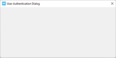

    I run again the IDE. This time I was going to log in but I got a blank window with no credentials asked:
    I am using a trial virtual machine with Windows 11 Pro v21H2 (22000.2538). After restarting the machine, I was able to log in.
