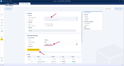

I wanted to note one issue related to the 'Save As' feature.
After I enter the project name (I2C_new_project_name) and the project repository (/home/gil/.../I2C_new_project_name) I click the Save button. I open the newly created ioc2 file with a text editor and I notice that the source code path is the one of the old project:
"CMake": {
"outputPath": "I2C_old_project_name_cmake",
"toolchain": "GCC",
"exportSource": "include-packs-from-local",
"removeBoard": true
I was expecting to see the source code path of the new project. Sure enough if I generate the project with this ioc2 file it will write to the I2C_old_project_name_cmake directory.
I edited the ioc2 file  to change the source code path to the new path to fix this issue.

Hello @gil_dobjanschi
I'm glad that you found a workaround. The issue has been reproduced and reported to the dev team for a fix. I’ll keep you posted.
Internal ticket number: CDM0062334 (This is an internal tracking number and is not accessible or usable by customers).
As a workaround, I suggest editing the Destination before generating the new project to update the source code path to the new location and avoid this issue.
