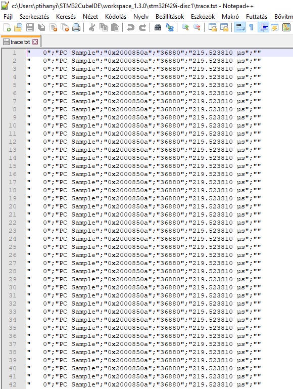

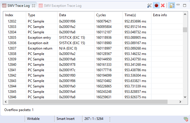

When I want to copy data records from any of the SWV views/windows, an interesting bug (or feature?) appears:
- When I select less than 1000 lines (or records), I can copy/paste selected data to any text editor
- When selected data contains more than 1000 records, CTRL+C activates a "Save AS" dialog, and it saves a CSV file contains repeating lines

‎2020-07-28 11:47 AM
Works for me now based on fresh STM32CubeIDE 1.4.0 release.
