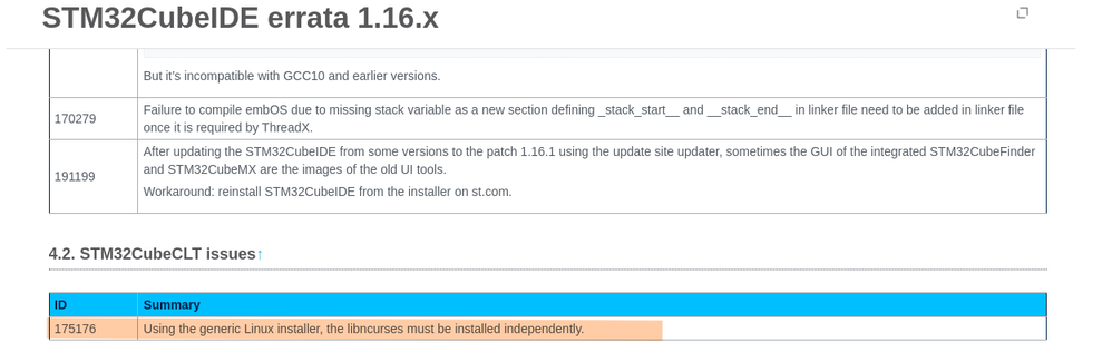

st-stm32cubeide-1.15.1 : Depends: libncurses5 but it is not installable
Depends: libpython2.7 but it is not installable
Depends: libwebkit2gtk-4.0-37 but it is not installable
E: Unable to correct problems, you have held broken packages.

Current version is 1.16.1:
https://community.st.com/t5/stm32cubeide-mcus/stm32cubeide-1-16-1-released/td-p/721704
yeah i had tried that as well but was showing the same error

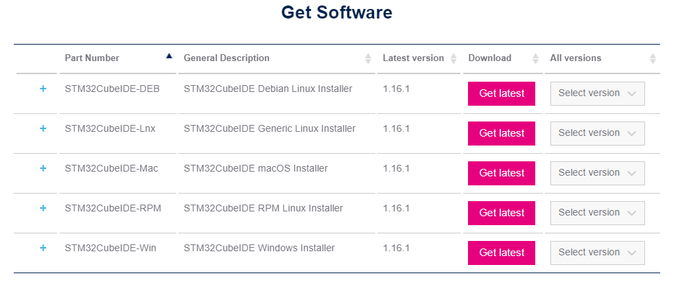

@shri1 wrote:
i had downloaded 1.15 stm32idecube linux installer
Which one?
There are three:
https://www.st.com/en/development-tools/stm32cubeide.html#get-software
generic linux installer second one
stm32cubeide_1.15.1_21094_2012_1041_amd64.deb_bundl
