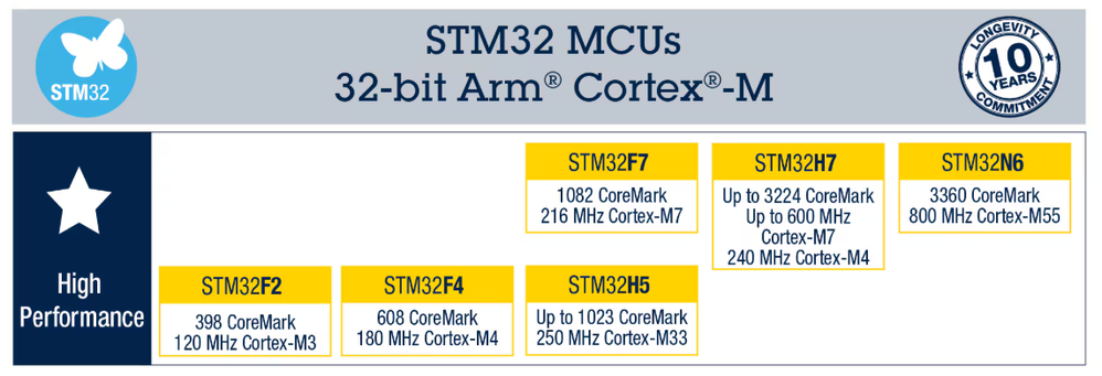

@KnarfB wrote:
Fx can be Cortex-M0 or Cortex-M4.
Also M3, M33, M7, M55:
@dwarakanath so did you mean F4 ?
