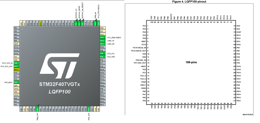

I want to switch a project in cubemx from stm32f407 to the stm32h753. (both lqfp100
in cubeMX 6.8.0 there is this pinout feature to show compatible cpus.
cubeMX lists me all the variants of the stm32F4, L4 and F7 but there are no H7 listed.
Is there a reason for that i'm missing?

does not look that incompatible to me

‎2023-03-17 3:57 AM
thanks. this way works better and i get some error messages and can import the project
it seems like CAN was the problem. the H7 has no CAN only can-fd and this was reported as error and seems to mark it incompatible although normal CAN is possible
