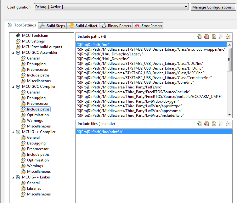

" "MCU GCC Compiler" → "Includes" to ensure that the correct source file is set as the main file."
No such path.
There is Include Paths but no setting for .c

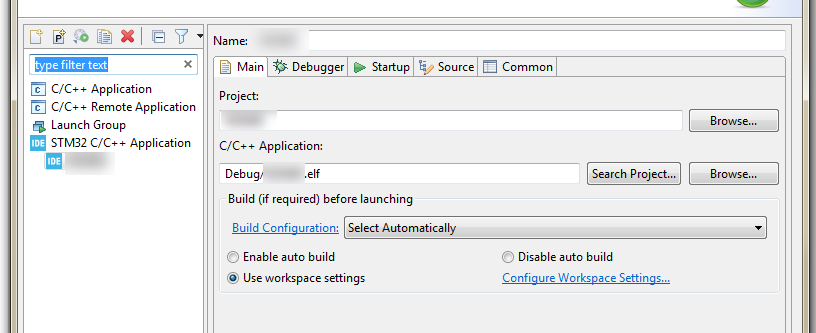

"make sure that the "Main" tab has the correct main file specified."
There is only the .elf specified and if it wasn't then nothing would run
