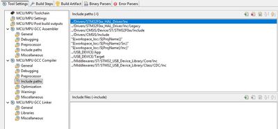

Hi. I am new to STM32 microcontroller. I started with STM32Cube IDE. So far everything is good until a build of a template project failed. I changed the directory structure of template project and moved folders Src, Inc and Startup to project root and removed Core folder. Now project wouldn't build. Although it generates binaries but with errors. I have also updated the Include paths in project properties but linker keeps failing. This is not a big deal I can move everything back to its original position and it will compile and link without any issue. I am just curious that what is missing. Just want to know what is going wrong. This is the error I am getting multiple times.
What was the purpose of that reorganisation? If it was working fine, why change it?
Note that the messages you posted are just warning - not errors.
They refer to file handling support (close, seek, read, write),  which is irrelevant if you don't do any file handling in your project - which is generally the case for microcontroller projects.

To be honest, no specific purpose for this reorganization. I came across a project which, probably, was created in the older version ST32CubeIDE. I loaded it in version 2.0.0 and it was built without any warning and message. I noticed the change in my project and reorganized according to that project.
Now to get to root cause of these messages is for information and learning purposes only. I don't mind putting these folders back to Core folder but I just want to know why these messages don't show up when these folders are in Core folder and what actually changes when they are in project root folder and makes them appear.
I hope you are getting what I want to say. Is it possible to get rid of these messages.? Again, I just want to learn how thing are working and how build system operates.
