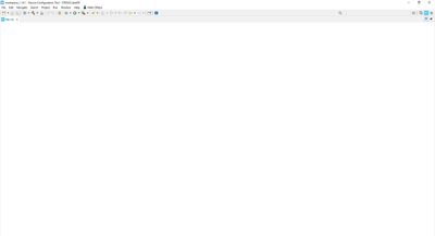

Hi everyone,
Actually, the subject line describes my problem completely. I tried to improve my IOC file yesterday with debugging, checked it again this morning, and it was working perfectly. But now, after an update or something similar, it suddenly won't open anymore; it’s just white. When I try to restore it with the main.c file, it doesn't work either, or it is empty. When opened as a text file, you can see something, so it’s not actually empty.

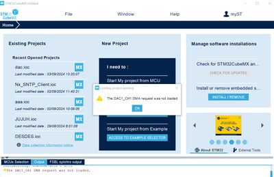

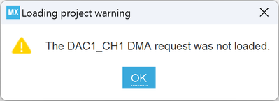

It loads for me but I get this warning:
Try to replace it with the attached.
Hello @hannah
When I open this .ioc file I have this problem and the .ioc file is empty:

Do you have any idea, why comes this warning, or what should i change maybe in text file, so i can open it normally?
hannah
i cant open it at all, so i cant also change that. If you are able to open it, may you please change that with Channel5 instead of Channel 1?

i leave a pic of my screen, when i try to open the file.
