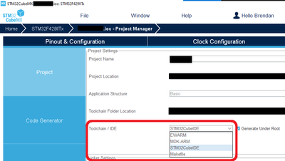

I'm proposing a new option for "Toolchain / IDE" selection.
Which option? a new type of CMake project?
Your first bullet sounds like a separate potential feature request?
Yes, you're right.
Oh, I see later versions of CubeMX have a CMake option in the pulldown (contrary to my screenshot). I'm in the process of updating our project to use later CubeMX and libs...
