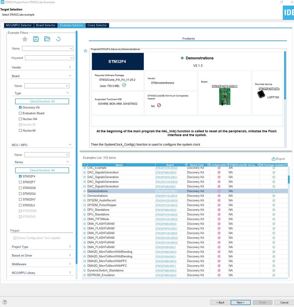

Not fully aware of example you're looking at. But here is way to deal properly with examples import.
1) If luckily your example is part of integrated ones (sounds work in progress here release after release) example import can be done relying on example selector
Let's try this way: File> Import > General > Import STM32Cube Example

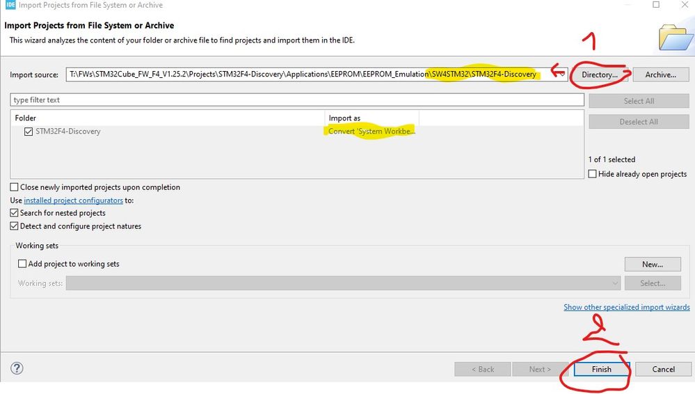

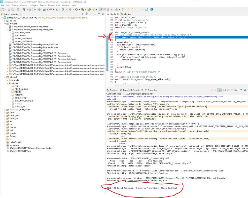

Works like a charm on my side if doing a small patch to such example code source (not STM one by the way ...):
0693W000007CygxQAC.jpgI've just done File>Open Project From File System then removed 'static' as part of highlighted line if snapshot. If not compiler is complaining your prototype is not in sync. with function implementation what's a good warning ...
