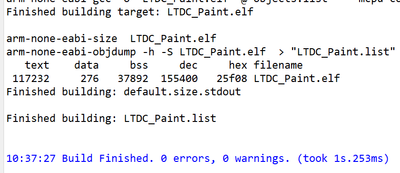

  • By Copy and paste LTDC_Paint folder, and rename to MyProject.
  • Then open .project and rename the project name to MyProject.
  • Then Delere the Debug & Release folders and delete .launch file
  • I then Rebuild the Debug and the Release.
  • Set the Run and Debug Configurations and all is good.
Not sure if this is the right way, but it works.
