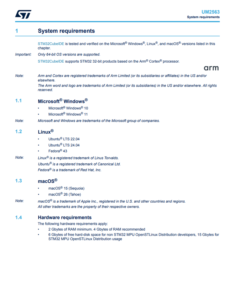

Hello @Amplifier
Windows 7 is not among the officially supported operating systems for STM32CubeIDE 2.1.0.
For STM32CubeIDE 2.1.0, the supported operating systems are:
• Microsoft® Windows® 10
• Microsoft® Windows® 11
THX
Ghofrane

Hello @Amplifier
Could you please specify your OS?
THX
Ghofrane
Windows 7 x64.
The problem was in Windows OS.
I've swapped SSD to the newer laptop. And the OS was partly dammaged. Everything works but some programms can't start.
