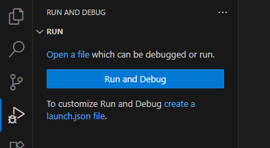

Missing the tasks.json file required for code flash.
horizon105457
I’m using the pre-release STM32Cube for Visual Studio Code (v3.5.1).
After importing a project that was originally generated by STM32CubeMX with the “cmake” toolchain selected, the .vscode folder is created but contains neither tasks.json nor launch.json.
When I try to add tasks.json manually, the command palette no longer offers the usual templates such as “STM32: CubeProg: Flash project (SWD)”.
Could you confirm whether this is a regression in 3.5.1?
If an immediate fix isn’t possible, would you mind sharing the correct tasks.json and launch.json snippets so I can paste them in by hand?

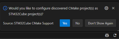

So starting 3.4.11 extension versions (currently all pre-release to collect feedbacks) the experience has been updated a bit:
+ Already no need any more to import a project what is not so VSCode way of working. You just have now to add a project your VSCode workspace and like CMake tools extension is doing we are discovering live if added material may be a STM32Cube candidate. As end user you have to confirm it or not.
Part of new experience .. we are forcing nobody: end user has to get the control.

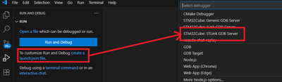

+ Once your project is a STM32Cube one, launch.json (and device flashing coming with) is generated either live under the hood pushing "Run & Debug" button
or if more control required, you can ask for "create a launch.json file" or add an extra configuration if exists already.
Based on launch.json we are fully supporting rich editor experience ... please rely on code completion to access the power of rich debug session we are supporting.
