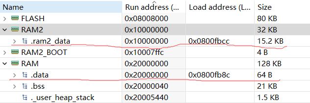

I want to use stm32CubeIDE's GCC compiler to compile my project, but the program takes up too much Flash space
Lucky Dog
The optimization options for GCC compilation are: Optimize for size(-Os),The compiled result is as follows:
0693W00000SwIogQAF.png The size of MCU Flash resources occupied is: text+data = 47264 Byte

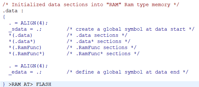

The.ld link script is shown below:

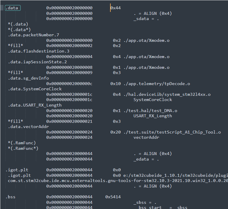

0693W00000SwIpoQAF.png Question: In my program, the.data segment data (initialized variable) can not be 15K, in theory only 0x44 bytes size, this can be seen from the map file, as shown below:

I have just modified the link script, the NOLOAD keyword was added,as follows:
.ram2_data (NOLOAD):
     . = ALIGN(4);
     _sram2 = .;
     *(.ram2_data)
     *(.ram2_data*)
     . = ALIGN(4);
     _eram2 = .;
  } >RAM2 AT> FLASH
  .ram2_boot (NOLOAD):
     . = ALIGN(4);
     _sram2_boot = .;
     *(.ram2_boot)
     *(.ram2_boot*)
     . = ALIGN(4);
     _eram2_boot = .;
  } >RAM2_BOOT AT> FLASH
0693W00000SwKeEQAV.png​ The compiled results are now almost identical to KEIL.

I forgot to mention that I defined a bunch of global variables into RAM2, about 15k in size, but I didn't initialize them, and they shouldn't be in the .data segment, they should be in the .bss segment. as shown below:
waclawek.jan
>RAM2 AT> FLASH means, they are both in RAM2 and in FLASH.
The attribute mechanism of gcc places those data unconditionally into a given section. The implicit magic of splitting to .data and .bss based on explicit initialization applies only to those variables which are not explicitnly assigned to a given section.
.ram2_datas says, size 15.2kB, does that ring a bell?
