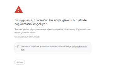

Google does not find the site safe. I removed all firewalls but it still refuses to download. There was another way to download it. Any chance of sharing via email or github?

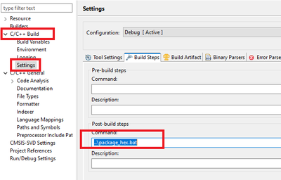

Basically this is how the command works: srec_cat.exe FIRST_HEX.hex -Intel SECOND_HEX.hex  -Intel -o OUTPUT_HEX.hex -Intel
You need to install SRecord utility (in the attachement) and follow the same procedure provided by GHolc.1 in https://community.st.com/t5/stm32-mcus-boards-and-hardware/production-flash-tool-for-dual-core-stm32h745/m-p/640740 to create .bat file and call if in Post-Build as shown here:
I didn't test the procedure. If It doesn't work, please contact your local FAE as you have a high-volume project.
