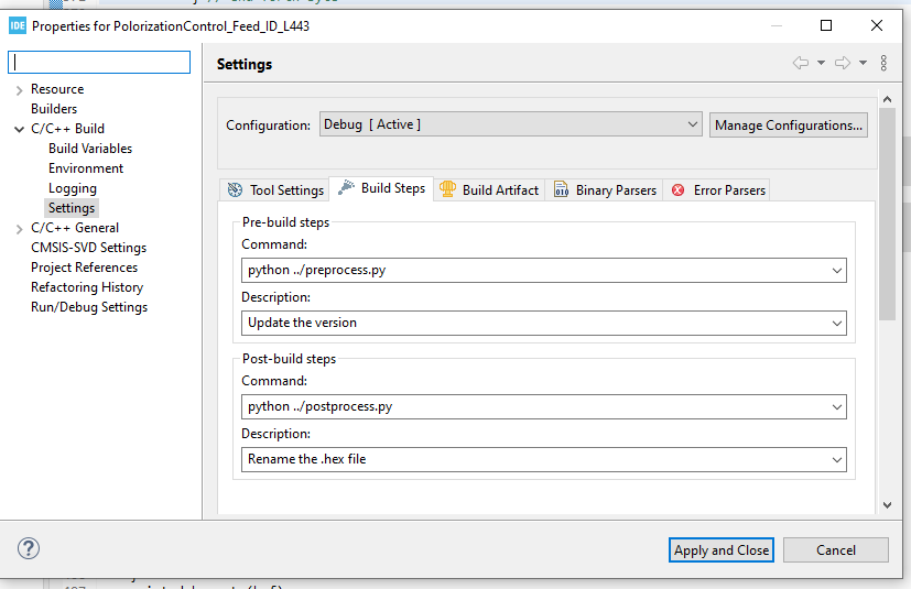

I set the Project->Properties->Tool Settings Tab->MCU Post build outputs
And clicked "Convert to Intel Hex file (-O ihex)
 Then you have to have the IDE program call them. Select the Build Steps Tab
4 REPLIES 4
Bob S
Add a "post compile" build step that runs a batch (or even better as shell/bash script) to do this. Go to the project properties, an don the "C/C++ Build"->"Settings" dialog, click on the "Build Steps" tab.
KiptonM
Lead
I think I have a start.
I was looking at the Properties->C/C++ Build->Settings->BuildSteps Tab and they have a pre-build command and a post-build command.
So I can create version.h file that looks like this:
 * Version.h
 *  Created on: Feb 3, 2023
 *      Author: Moravec-Kipton
#ifndef INC_VERSION_H_
#define INC_VERSION_H_
#define AUTOVERSION "10.1_0_69755423"
#endif /* INC_VERSION_H_ */
During the pre-build I can update the string in the Version.h file with a python or bash script. grabbing all of the pieces from where they are on my computer. It looks like my file name can have multiple "." in it. I am not used to that. (I am an old guy.)
In the post-build I can use that string to rename the .hex file. with a script or another small python program.
In my program I can make that string go out with the appropriate I2C version command.
Is there a better way to do it?
