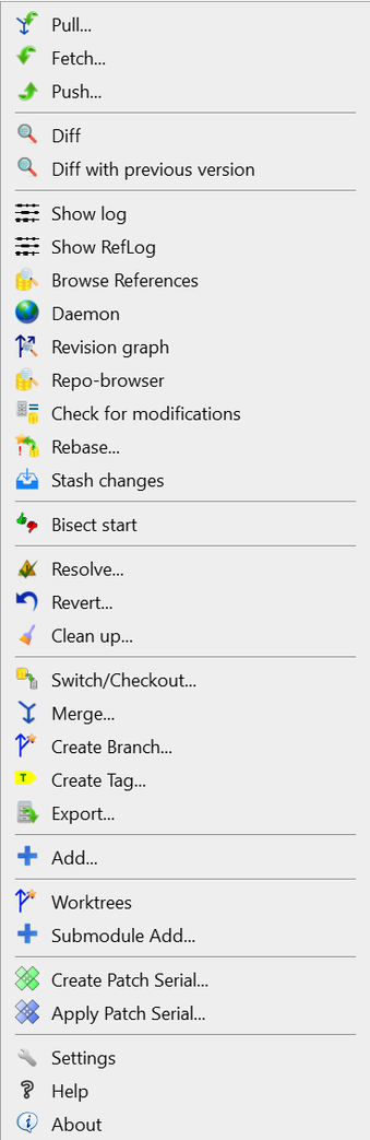

You can either use a plugin in STM32CubeIDE by searching in the Eclipse Marketplace under the Help menu, or you can use a 3rd party Git interface. I like using TortoiseGit which you can use on other types of folders that are not an STM32 project. It has a lot of features
