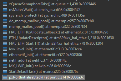

I would like to setup a system with a telnet server and I'm trying to follow this guide: https://controllerstech.com/stm32-ethernet-4-tcp-server/ but unfortunately, upon launch, the system gets stuck at line1438 in queue.c:
/* Cannot block if the scheduler is suspended. */
#if ( ( INCLUDE_xTaskGetSchedulerState == 1 ) || ( configUSE_TIMERS == 1 ) )
configASSERT( !( ( xTaskGetSchedulerState() == taskSCHEDULER_SUSPENDED ) && ( xTicksToWait != 0 ) ) );
#endif
it's a bit odd because it appears like when I don't change the MEM_SIZE variable but leave it its default (1600) it appears to not be stuck after creation of the config but once I change it to 10*1024 (as it's shown in the link above) I do not seem to be able to undo it anymore but it keeps getting stuck on call to MX_LWIP_Init(). Why is this I'm wondering and how can I fix it?

The code gets 'stuck" in queue.c because some function is waiting for a queue (or mutex) with a non-zero "wait" param BEFORE the FreeRTOS scheduler has started (osKernelStart() called).  That is not allowed - as the comment says, tasks cannot be suspended if the scheduler is not (yet) running.
Where in MX_LWIP_Init() is the code getting "stuck"?  Use the debugging tools, trace/step through the function.
If you are using dynamic allocation for your tasks, mutexes, queues, etc. then you definitely need to set MEM_SIZE much larger than the default 1600.  I don't know what you mean by "do not seem to be able to undo it anymore".

and the call stack when it hangs looks like this:
What I see is happening is:
  1. MX_LWIP_Init() calls
  2. netif_add() calls
  3. init(netif) calls
  4. low_level_init(netif) calls
  5. HAL_ETH_Start_IT(&heth) calls
  6. ETH_UpdateDescriptor(heth) calls
  7. HAL_ETH_RxAllocateCallback(&buff) calls
  8. LWIP_MEMPOOL_ALLOC(RX_POOL) calls
  9. do_memp_malloc_pool(desc) calls
  10. SYS_ARCH_PROTECT(old_level) calls
  11. osMutexWait(lwip_sys_mutex, osWaitForever) calls<-- problem is invoked from here
  12. if (xSemaphoreTake(mutex_id, ticks) != pdTRUE) calls
  13. configASSERT( !( ( xTaskGetSchedulerState() == taskSCHEDULER_SUSPENDED ) && ( xTicksToWait != 0 ) ) ) HANGS
any hints on how I can fix this? I've attacghed the empty project as *.7z file

I have the same problem that is represented in the capture, I get stuck at the same point. I have seen this problem in a nucleo-f439zi. I have tested also the cmsis os v2 and it doesn´t work either. This problem happened with the cmsis os v1. I think that the problem is because of a wrong configuration in LWIP or FreeRTOS.
