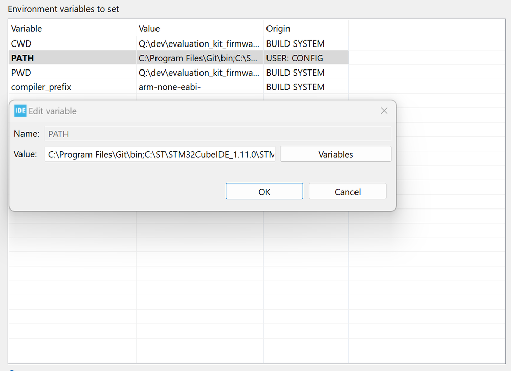

Oh, Finally it worked like this for me:
It's important to put this address "C:\Program Files\Git\bin;" in the PATH of IDE, at the beginning and before other things, like this:
0693W00000Y8OYYQA3.pngthen in the build command part I just wrote "bash":

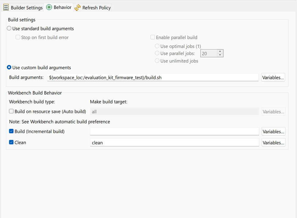

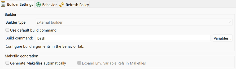

0693W00000Y8OZbQAN.pngand in the next tab -Behavior- I entered the address of bash like this:
0693W00000Y8OaKQAV.pngIt seems to me that I can only enter the address of the script as an input for bash command here. right?
