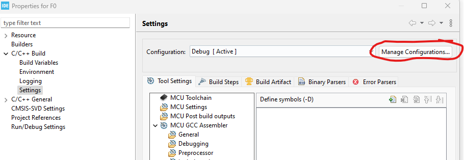

Hi!
I have tested this in all my projects.
I have several compilation flavours with several symbols but you can test this issue only with default flavours: Release and Debug.
  1. Delete DEBUG preprocessor symbol in Debug flavour
  2. Open device configuration tool
  3. Click code generation
  4. After that, DEBUG symbol is again added to Debug flavour.
This symbol is not used and isn't a problem but in my projects and flavours I want not this symbol because may be confused to others developers. I can solve it by creating flavours based in Release but I would like to know if there is any option to avoid this behaviour
Thanks!!
Cartu38 OpenDev
Lead III

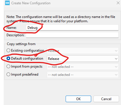

No option. Hardcoded behavior if debug type build configuration.
As workaround possibly remove original Debug configuration and create a new one based on Release type
0693W00000Y8n2wQAB.pngTakes care starting from Release type, compiler optimizations are not debug compliant so you will have to set them to proper values
