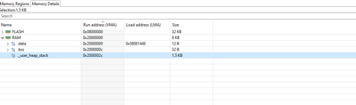

The example project above is basically just declaring global array array_test_global and then later I declare array_test_local
I place breakpoints in various positions and monitoring via Build Analyzer tool:
But I cant see the variables that I declare in the memory.

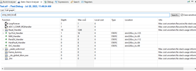

I have also tried to look at Static Stack analyzer but cant see anything usefull there either:
Can someone point me in the right direction and help me understand how to properly monitor stack and heap memory (see which variables are declared in stack memory and their address, also see which variables are declared in heap memory and etc).

‎2023-07-31 9:20 PM
Please see my example project and how I tried to use the static stack analyzer.
You can see in my example project that I create a few large arrays:
uint8_t array_test_global[2000] = {0};
uint8_t array_test_local[1000] = {0};
but they are not showing up on the static stack analyzer.
‎2023-07-31 10:38 PM
That's probably because your variables are not used in the project and optimized away by the compiler&linker. Make the definitions volatile and/or add some code using the arrays in a nontrivial way, like computing a checksum,...
hth
KnarfB
‎2023-08-01 3:14 AM - edited ‎2023-08-01 3:20 AM
I have thought about the fact that maybe this is because I am not using my variables in the project so they are optimized away. That is exactly why I have added:
array_test_global[4] = 2;
array_test_local[5] = 10;
To make sure they are being used. Is that not enough? I would assume at least something should show up in stack analyzer.
‎2023-08-01 3:19 AM
No. The optimizer is smart, so if you never use those variables, it won't create the array.
Even if you use it in some simple way, it may figure out that the array is not needed.
Use volatile.

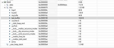

‎2023-08-01 5:37 AM
Thank you for explaining.
From what I understood, static task analyzer is for analyzing functions.
I have created a 1KB buffer:
volatile uint8_t test_buffer[1024];
and then I perform some actions in while loop:
while (1)
HAL_Delay(1500);
/* USER CODE END WHILE */
static uint8_t counter = 0;
test_buffer[counter] = 5;
counter++;
/* USER CODE BEGIN 3 */
I can confirm that I can see the variables in memory details:
‎2023-08-01 6:16 AM
test_buffer is a global variable. It's in the .bss section (which are implicitly zeroed global variables) so you won't see it in the stack analysis, as it's not created on the stack.
