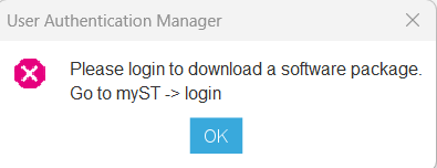

I have seen the  @Peter BENSCH 's  Window > Preferences > Network connections solition but I couldn't fix the problem. I can't generate code because of this error. How can I fix it ? Have somebody ever encountered like this problem ?

Hello @aykutz ,
Which CubeMx version are you using?
Could you please share your STM32CubeMX.log.
Please try to follow the steps:
  • Delete user/.Stm32CubeMx
  • Run latest STM32CubeMx version
  • Click on MyST > login
  • Click on Help > Updater settings > Connection Parameters > Check Connection.
  • Click on MyST-->login
If the Check connection button shows a green check mark (connection is up), click it. The
button should be refreshed to show a fuchsia cross (connection failed). Adjust the
parameters to match your network configuration and click the “Check connection” button
again. Once the green check mark appears (connection back up), you may proceed with the
download.
You can refer to the FAQ section in the UM1718 for more details.
Imen
