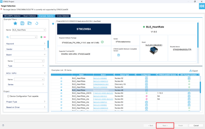

I tried developing for the NUCLEO-WBA25CE1 using BLE_HeartRate, but even after selecting it, the Next button is disabled.
Could you please suggest a good way to develop for this board?

Hello @gocchan
Let me thank you for posting.
I reproduced the behavior described and I was able to generate the example mentioned through STM32CubeMX 6.17.
Thanks.
Mahmoud
2026-05-08 1:28 AM - edited 2026-05-08 2:43 AM
@gocchan Note that CubeMX and CubeIDE are now separate applications (since IDE v2.0.0).
Project creation & configuration is done in CubeMX - no longer in CubeIDE.
See: STM32CubeIDE 2.0.0 New workflow tutorial.

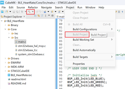

2026-05-10 11:08 PM
Thank you everyone.
I installed CubeIDE 2.1.1 and CubeMX 6.17.0.

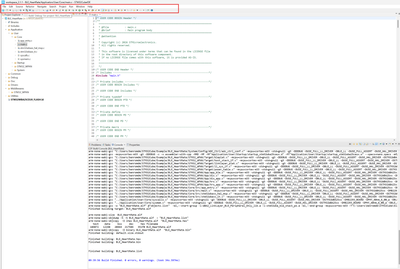

I was able to create a project in CubeMX and load it into the IDE, but I can't build it (the build button is not active).
Do you know the reason for this?
2026-05-11 1:44 AM
Hello @gocchan
Based on your comment and the screenshot you shared, it appears that you have imported the EWARM, MDK-ARM and STM32CubeIDE folders.
I recommend that you delete the [ BLE_HeartRate Example] and regenerate it with STM32CubeMX.
Thanks.
Mahmoud

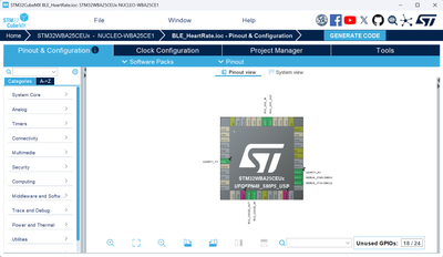

2026-05-11 11:19 PM
I tried generating a sample project from CubeMX again. I can now press the build button, but I don't know how to resolve the build errors.

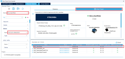

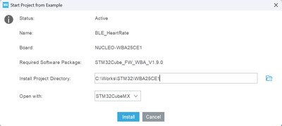

The steps I took are as follows:

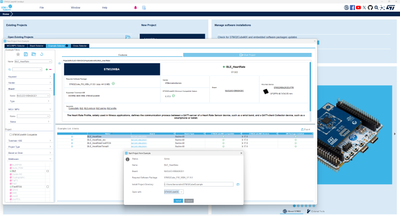

On the home screen, select ACCESS TO EXAMPLE SELECTOR, choose BLE_HeartRate/NUCLEO-WBA25CE1, and press Start Project.
Set Open with: to STM32CubeMX and press Install.
The Pinout view is displayed. At this point, LEDs 1-3 and Buttons 1-3 do not appear to be assigned (how can I assign them?).

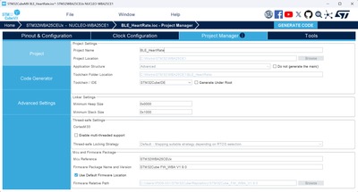

Set Toolchain/IDE to STM32CubeIDE and press GENERATE CODE.
I can now press the build button, but I'm getting build errors.

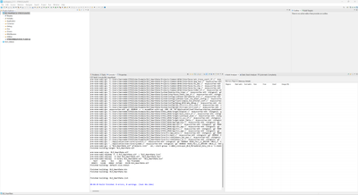

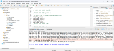

Error message:
make: *** No rule to make target 'C:/Works/STM32/WBA25CE1/BLE_HeartRate/Drivers/STM32WBAxx_HAL_Driver/Src/stm32wbaxx_ll_dma.c', needed by 'Drivers/STM32WBAxx_HAL_Driver/stm32wbaxx_ll_dma.o'. Stop.
make: *** Waiting for unfinished jobs....
2026-05-12 2:14 AM
Hello @gocchan
The issue has already been reported to the dedicated team under this internal ticket (Ticket Number: CDM0060308).
Solved: Missing file after file generation - STMicroelectronics Community
Solved: Re: [BUG] BLE_p2pServerThreadX RAM Overflow on NUC... - STMicroelectronics Community
Thanks.
Mahmoud

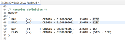

2026-05-13 6:39 PM
Hello @Mahmoud Ben Romdhane
I tried one of the solutions suggested in the ticket, setting the RAM size in the linker script to 128K, but the build error persisted. The flag (-z noexecstack) is also set.
The build error seems to indicate that some necessary source files are missing, so I think the other ticket is important. Has CDM0060308 been resolved?
When I created another project (BLE_p2pServerThreadX), stm32wbaxx_ll_adc.c was present, so I copied it to BLE_HeartRate, but then I got an error indicating that another file (Common/WPAN/Interfaces/app_bsp.c) was missing.
