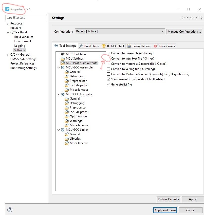

Despite I would be worried about such missing arm-none-eabi-objcopy.exe file as sounds post build step doing .elf to .hex is failing have a try to just skip it. .hex is just an extra binary you don't care about. .elf is far best one.
Just right click on your project root within project explorer. Select Properties as part of contextual menu then uncheck .hex generation:

When I built a project for the Nucleo-F446RE I look at Project->Properties->C/C+ Build->Settings under the Build Steps Tab there is nothing under Post-build steps.
With the usart_dma_rx_idle_line_irq_F4 progect in the same place it has
arm-none-eabi-objcopy.exe -O ihex "${BuildArtifactFileBaseName}.elf" "${BuildArtifactFileBaseName}.hex"

Deleted the post build command with arm-none-eabi-objcopy.exe program. I have searched the whole computer and did not find the file. )
Compiled Project with no errors or warnings.
