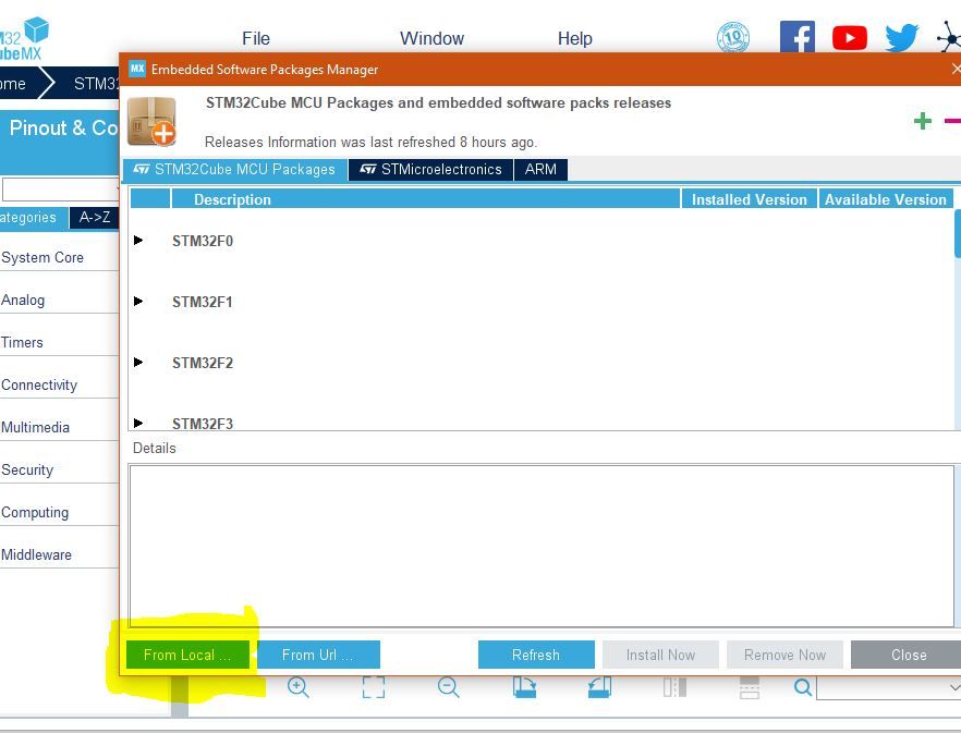

How to install it manually. IS there a oportunity to install it and keep it as a .zip-file?​

You can use STM32CubeIDE or STM32CubeMX to install the downloaded .zip file (STM32CubeIDE: Help > Manage Emb. SW Packages > From Local...)
The .zip file will be copied and unzipped to %USERPROFILE%\STM32Cube\Repository (win) or $HOME/STM32Cube/Repository (Linux). The .zip file stays there for reference.
If you have already unzipped the file to a folder of your choice, in CubeMX Project Manager you have the option to select a custom firmware folder like %TEMP%\stm32cube_fw_f7_v1160\STM32Cube_FW_F7_V1.16.0 (although the file dialog really *****).
hth
KnarfB

CUBMX >Help> Manage embedded software packgages
hth
KnarfB
