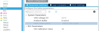

‎2023-12-04 11:17 PM - edited ‎2023-12-04 11:33 PM
using cube, it should set flash wait correct, see ->
and about alignment : you have to set it...if needed

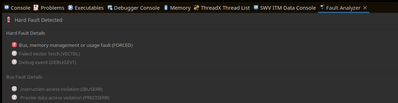

++ in ide: on debug (menu: window-> show view -> fault analyzer ) might help, after a hard fault, to see..

‎2023-12-13 12:18 AM
I configured the 'Flash wait states', with the call:
HAL_RCC_ClockConfig(&RCC_ClkInitStruct, FLASH_LATENCY_2);
and it's "Two wait states"... and it's already the highest value.
Anyway, I'll give you the rest of the clock initialization.
if you have any ideas...
Thanks
andrea
